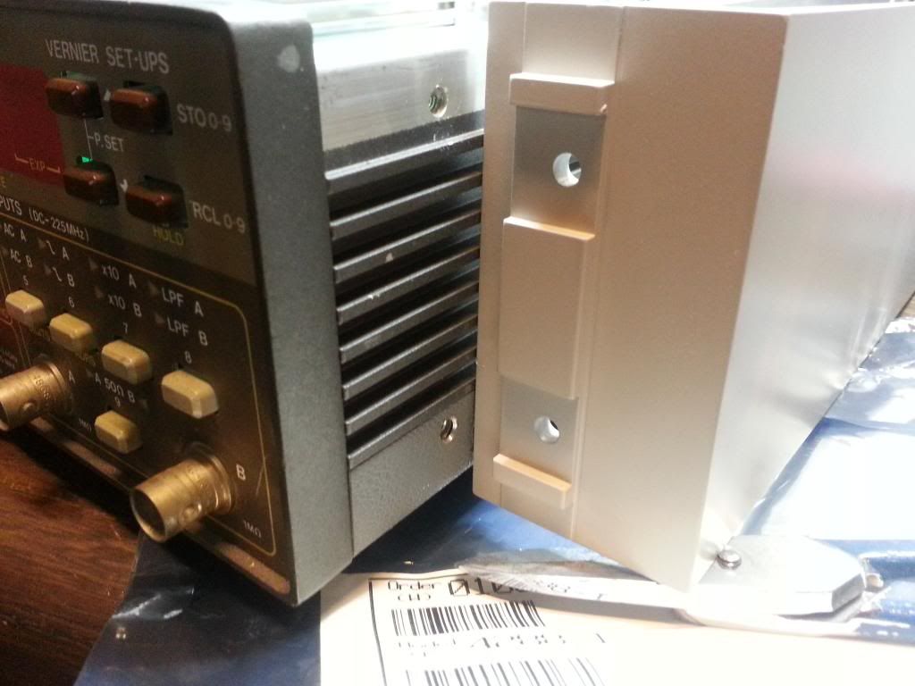

The 776 Counter recommended rack mount accessory "4288-1" does not fit the case. The screw holes are different, and the notch-to-case mount is very incorrect.

Yes, this particular listing is in error.
The single rack mount kit is the Model 7768.
The dual rack kit is the Model 4288-5.
The Model 776 and 7768 went obsolete in 2004.
